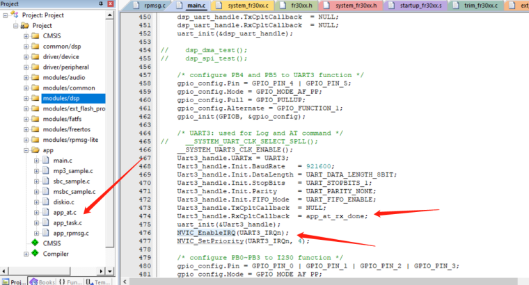

FR3092E 串口3的接收中断该如何配置?
void Uart_init(unsigned long baud){
__SYSTEM_UART3_CLK_ENABLE(); GPIO_InitTypeDef GPIO_Handle; /* Uart3 IO init */ GPIO_Handle.Pin = GPIO_PIN_4|GPIO_PIN_5; GPIO_Handle.Mode = GPIO_MODE_AF_PP; GPIO_Handle.Pull = GPIO_PULLUP; GPIO_Handle.Alternate = GPIO_FUNCTION_1; gpio_init(GPIOB, &GPIO_Handle); //__SYSTEM_UART_CLK_SELECT_COREH(); Uart3_handle.UARTx = UART3; Uart3_handle.Init.BaudRate = baud; Uart3_handle.Init.DataLength = UART_DATA_LENGTH_8BIT; Uart3_handle.Init.StopBits = UART_STOPBITS_1; Uart3_handle.Init.Parity = UART_PARITY_NONE; Uart3_handle.Init.FIFO_Mode = UART_FIFO_ENABLE; uart_init(&Uart3_handle); NVIC_ClearPendingIRQ(UART3_IRQn); NVIC_EnableIRQ(UART3_IRQn); //NVIC_SetPriority(UART3_IRQn, 0);
void uart3_irq(void)
uart_IRQHandler(&Uart3_handle);
麻烦那位看一下uart3的串口接收中断该如何配置?
