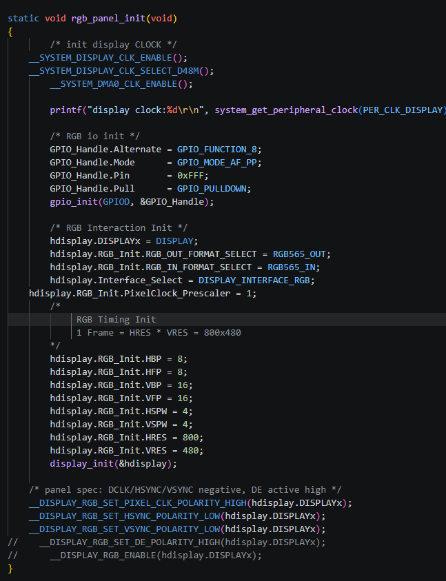

      static void display_psram_init(void)
      		pmu_psram_power_ctrl(true);
      		system_delay_us(1000);
      		if(psram_init(PSRAM_CLK_SEL_AUPLL))
      				printf("hw_psram_init\r\n");
      		else
      				printf("hw_psram_err\r\n");
      		#if 1
      			__CACHE_FLUSH(CACHE);
      			__CACHE_BANK_FLUSH(CACHE);
      			while (__CACHE_BANK_FLUSH_DONE(CACHE) == false);
      			__CACHE_WR_MODE_SET(CACHE, CACHE_WR_WRITE_THROUGH);
      			__CACHE_ADDR_RANGEx_BANK_SET(CACHE, 0, 0x00000000 >> 16);
      			__CACHE_ADDR_RANGEx_MASK_SET(CACHE, 0, 0x001F);
      			__CACHE_ADDR_RANGEx_POL_SET(CACHE, 0, CACHE_POL_CACHABLE);
      			__CACHE_ADDR_RANGEx_ENABLE(CACHE, 0);
      			__CACHE_ENABLE(CACHE);
      		#endif

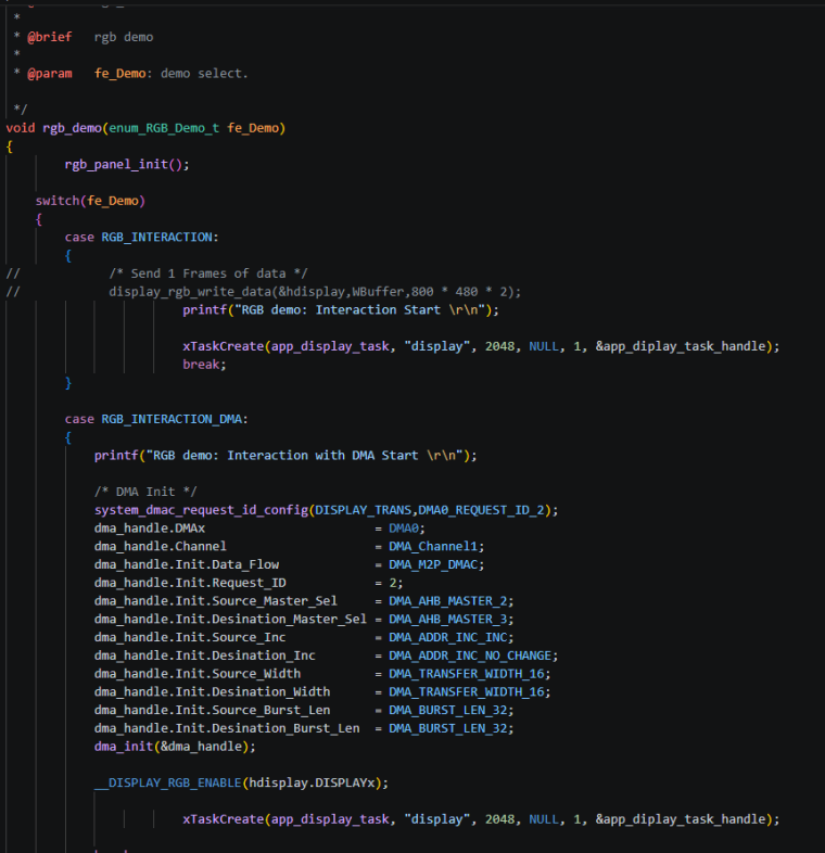

      问题2: v0.3.2 dma 传输数据异常 且dma_start_IT当地址指向为 (uint32_t)&hdisplay.DISPLAYx->TX_FIFO 时无法触发中断
      // 初始化
      		__SYSTEM_DMA0_CLK_ENABLE();
      		/* DMA Init */
      		system_dmac_request_id_config(DISPLAY_TRANS,DMA0_REQUEST_ID_2);
      		dma_handle.DMAx                       = DMA0;
      		dma_handle.Channel                    = DMA_Channel1;
      		dma_handle.Init.Data_Flow             = DMA_M2P_DMAC;
      		dma_handle.Init.Request_ID            = 2;
      		dma_handle.Init.Source_Master_Sel     = DMA_AHB_MASTER_2;
      		dma_handle.Init.Desination_Master_Sel = DMA_AHB_MASTER_3;
      		dma_handle.Init.Source_Inc            = DMA_ADDR_INC_INC;
      		dma_handle.Init.Desination_Inc        = DMA_ADDR_INC_NO_CHANGE;
      		dma_handle.Init.Source_Width          = DMA_TRANSFER_WIDTH_16;
      		dma_handle.Init.Desination_Width      = DMA_TRANSFER_WIDTH_16;
      		dma_handle.Init.Source_Burst_Len      = DMA_BURST_LEN_32;
      		dma_handle.Init.Desination_Burst_Len  = DMA_BURST_LEN_32;
      		dma_init(&dma_handle);
          /* panel spec: DCLK/HSYNC/VSYNC negative, DE active high */
      		NVIC_ClearPendingIRQ(DMA0_IRQn);
          NVIC_EnableIRQ(DMA0_IRQn);
      // 使用
      void rgb_demo(enum_RGB_Demo_t fe_Demo)
      		display_psram_init();
      		rgb_panel_init();
      		display_psram_buff = (uint16_t *)PSRAM_DAC_BASE;
      		for(uint32_t i = 0; i < RGB_ROW * RGB_COL; i++)
      				display_psram_buff[i] = LCD_COLOR_RED;
      		printf("+++++%04x+++++++",display_psram_buff[53]);
          switch(fe_Demo)
              case RGB_INTERACTION_DMA:
                  printf("RGB demo: solid color with DMA start\r\n");
                  __DISPLAY_RGB_ENABLE(hdisplay.DISPLAYx);
      						uint16_t buffl[64];
      						dma_start_IT(&dma_handle, (uint32_t)display_psram_buff, (uint32_t)&hdisplay.DISPLAYx->TX_FIFO, 64);
      						// for(uint16_t i =0;i<64;i++)
      						// 		printf("%04x",buffl[i]);
      //						xTaskCreate(test_task, "test_task", 512, NULL, 2, &test_task_handle);
                  break;
      extern int fputc(int c, FILE *fp);
      __RAM_CODE void dma0_irq(void)
      		void * temp = NULL;
      		g_dma0_irq_cnt++;
          if (dma_get_tfr_Status(&dma_handle))
              dma_clear_tfr_Status(&dma_handle);
      				fputc('D',(FILE*)temp);

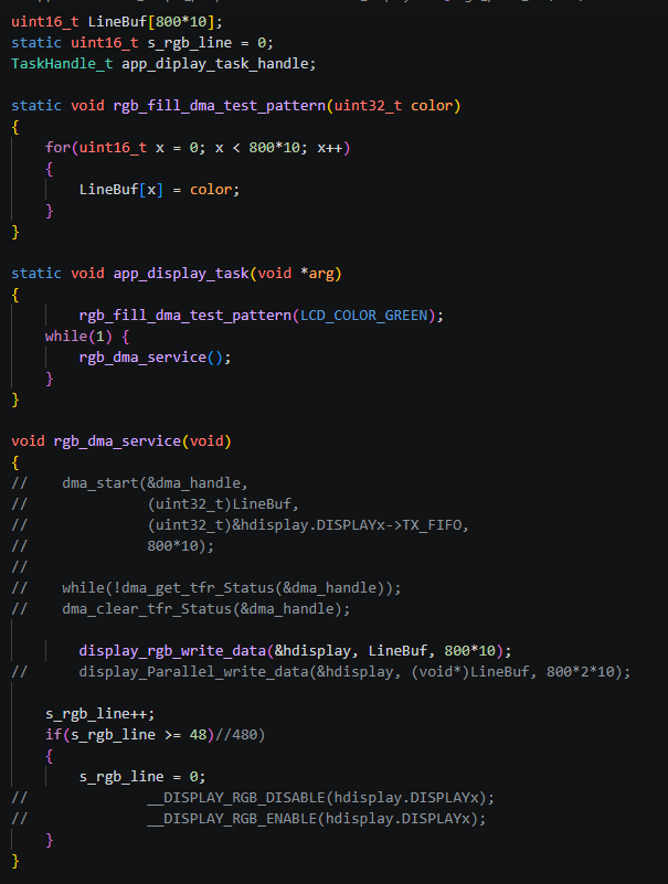

      开发板驱动开发板配套屏幕 驱动异常 参考例程:display 按照 display_dome.c内的驱动例程去驱动800480屏幕
      由于800
      480的数据太大故分包发送
      相关配置如下
      发送函数:
      尝试过多种方式当时都存在异常要么只亮背光、要么颜色跟传输颜色不一致

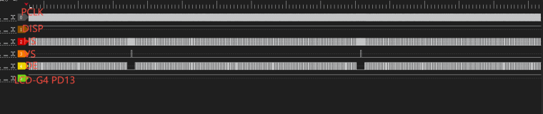

      使用逻辑分析仪读信号 hs vs de pclk 均有信号(高低电平) disp正常为高 但是抓取lcd-G4 却一直高
      太异常了 屏幕规格书上时序为de模式 fr306x的参考手册写明了是支持de模式的

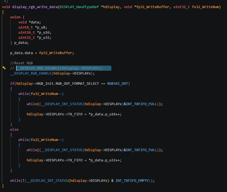

      传输数据的函数(修改过):
      发布在 FR306x
