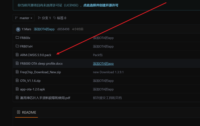

https://gitee.com/YgqMars/freqchip
1、It is recommended that you use it keil V528 https://armkeil.blob.core.windows.net/eval/MDK528.EXE
2、Solve pop-up window M3 to install this .pack

@sekibetu keil V5 53x will compile errors, need to install 525 after the installation, and then overwrite the installation is also possible
pack:https://keilpack.azureedge.net/pack/ARM.CMSIS.5.9.0.pack
keli V5 528 https://armkeil.blob.core.windows.net/eval/MDK528.EXE
