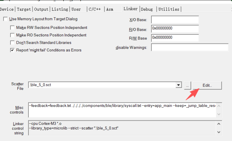

app中的.sct链接文件的起始地址改了吗
@zr 有改ROM 0x10020000 0x01000000;0x100000

@zr APP 的 sct偏移128KB bootloader 空间
ER_TABLE +0
*(jump_table_0)
*(jump_table_1)
*(jump_table_2)
*(jump_table_3)
*(jump_table_4)
}ER_RO 0x10022000 FIXED { *(+RO) } GUI_MENU_DATA +0 ALIGN 0x4 { *(gui_menu) } ER_BOOT 0x11000000 { boot_vectors.o (RESET, +FIRST) } USER_RE_RAM 0x11001000 { *(ram_code) } ER_RW +0 { *(+RW) *(STACK) } ER_STACK +0 { *(stack_section) } ER_ZI +0 { *(+ZI) } HEAP_KE +0 { *(heap_ke) }}

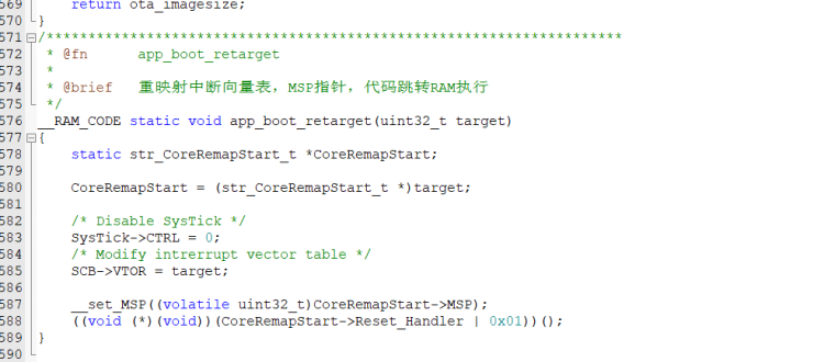

typedef void (*func_ptr_t)(void);
static uint32_t JumpAddr;
static func_ptr_t JumpToApp;
/**- @brief Jump from boot to app function.
- @param [in] u32Addr APP address
- @retval LL_ERR APP address error
int32_t IAP_JumpToApp(uint32_t u32Addr) // u32Addr = 0X10022000 // 0X20000 128KB bootloader 空间 + 0X2000偏移8KB jump表

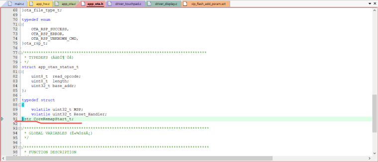

uint32_t u32StackTop = *((__IO uint32_t *)(u32Addr));
IAP_PeriphDeinit(); /* Jump to user application */ JumpAddr = *(__IO uint32_t *)(u32Addr +4);// printf("3 JumpAddr = 0x%08X \r\n",JumpAddr ); JumpToApp = (func_ptr_t)JumpAddr; /* Initialize user application's Stack Pointer */ __set_MSP(u32StackTop); // SCB->VTOR = u32Addr ; // JumpToApp();// app_boot_retarget(u32Addr);
return LL_ERR;}
