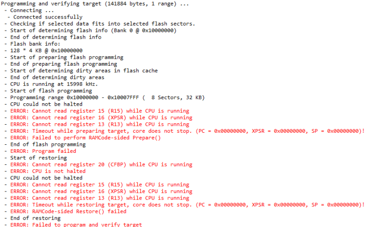

    we downloaded over UART a new FW version in the chip and commanded reboot but after reboot the BLE chip does not work anymore meaning that the new FW does not start and we cannot erase or program anymore the chip using SWD interface.
    probably we did some error in the UART update procedure (is under development), but the serious problem is that, from that moment, the chip can't be re-flashed with a valid FW even using the SWD interface.
    when using JFlash we successfully connect to the device it's ok but sending Erase chip command we got errors or sending Erase sector we got errors also trying to Program the device results in errors.
    During JFlash SWD operation, the FR8000 chip seems to reset itself several times.

    3_1781359445506_connect.png 2_1781359445506_erase chip.png 1_1781359445506_erase sector.png 0_1781359445505_programming.png
    which is the root cause of the situation we generated with our UART FW update attempt?

    https://gitee.com/a18562560220/freqchip_faq/blob/master/Freqchip芯片烧录与环境搭建(1).pdf
    You can try using our burning tool to erase the flash memory of the chip.
