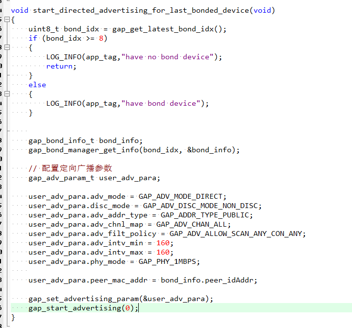

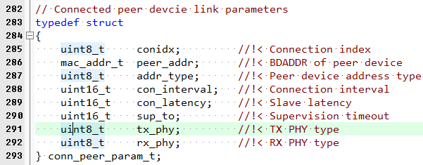

<?xml version="1.0" encoding="UTF-8"?><rss xmlns:dc="http://purl.org/dc/elements/1.1/" xmlns:content="http://purl.org/rss/1.0/modules/content/" xmlns:atom="http://www.w3.org/2005/Atom" version="2.0"><channel><title><![CDATA[FR8008A 定向广播]]></title><description><![CDATA[<p>请问FR8008A怎么实现定向广播 目前的写法绑定成功后（成功执行回调），然后断电重启执行定向广播 ，但是APP端无法连接<br />
<img src="/assets/uploads/files/1778147990018-b4b03baf-4e38-46e4-896e-30b7a94d0a33-image.png" alt="0_1778147989204_b4b03baf-4e38-46e4-896e-30b7a94d0a33-image.png" class="img-responsive img-markdown" /><br />
<img src="/assets/uploads/files/1778147921921-d32fcef9-d718-4173-9391-933f2464ccb1-image.png" alt="0_1778147921081_d32fcef9-d718-4173-9391-933f2464ccb1-image.png" class="img-responsive img-markdown" /> <img src="/assets/uploads/files/1778147859413-eeeaa758-c47c-41ea-8962-afda03ca8462-image.png" alt="0_1778147858601_eeeaa758-c47c-41ea-8962-afda03ca8462-image.png" class="img-responsive img-markdown" /></p>
]]></description><link>http://www.freqchip.net:4567/topic/1789/fr8008a-定向广播</link><generator>RSS for Node</generator><lastBuildDate>Sat, 09 May 2026 01:58:19 GMT</lastBuildDate><atom:link href="http://www.freqchip.net:4567/topic/1789.rss" rel="self" type="application/rss+xml"/><pubDate>Thu, 07 May 2026 10:00:54 GMT</pubDate><ttl>60</ttl><item><title><![CDATA[Reply to FR8008A 定向广播 on Invalid Date]]></title><description><![CDATA[<p>请问FR8008A怎么实现定向广播 目前的写法绑定成功后（成功执行回调），然后断电重启执行定向广播 ，但是APP端无法连接<br />
