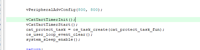

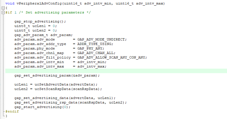

]]></description><link>http://www.freqchip.net:4567/post/4323</link><guid isPermaLink="true">http://www.freqchip.net:4567/post/4323</guid><dc:creator><![CDATA[ZR]]></dc:creator><pubDate>Invalid Date</pubDate></item><item><title><![CDATA[Reply to 请教一下：在调用 system_sleep_enable之前修改广播间隔不生效 on Fri, 24 Apr 2026 02:32:54 GMT]]></title><description><![CDATA[<p><img src="/assets/uploads/files/1776997851005-d140b3c8-700a-4a73-adb3-870bef746a94-image-resized.png" alt="0_1776997849871_d140b3c8-700a-4a73-adb3-870bef746a94-image.png" class="img-responsive img-markdown" /></p>
<p><img src="/assets/uploads/files/1776997961449-c295e561-398f-4ce8-afe7-cbe80fdb69d7-image.png" alt="0_1776997960550_c295e561-398f-4ce8-afe7-cbe80fdb69d7-image.png" class="img-responsive img-markdown" /></p>
<p>我按照这样修改的，但是广播直接就消失的，感觉是没有广播没有启动成功</p>

]]></description><link>http://www.freqchip.net:4567/post/4325</link><guid isPermaLink="true">http://www.freqchip.net:4567/post/4325</guid><dc:creator><![CDATA[YangYJP]]></dc:creator><pubDate>Invalid Date</pubDate></item><item><title><![CDATA[Reply to 请教一下：在调用 system_sleep_enable之前修改广播间隔不生效 on Invalid Date]]></title><description><![CDATA[<p><a class="plugin-mentions-user plugin-mentions-a" href="http://www.freqchip.net:4567/uid/1873">@yangyjp</a> 还有一点就是要去确定gap层产生了停止广播的事件，再去修改</p>
]]></description><link>http://www.freqchip.net:4567/post/4326</link><guid isPermaLink="true">http://www.freqchip.net:4567/post/4326</guid><dc:creator><![CDATA[ZR]]></dc:creator><pubDate>Invalid Date</pubDate></item></channel></rss>
